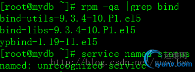

一、检查BIND包,缺少bind、bind-chroot包

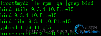

3、  检查安装的BIND包,Ok了!
[root@mydb ~]# service named status
rndc: connect failed: 127.0.0.1#953: connection refused
named is stopped
说明DNS没有配好,接下来就开始配置DNS。
