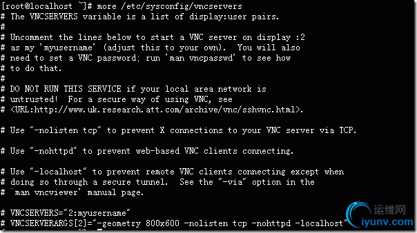

2、配置vncservers文件
修改/etc/sysconfig/vncservers文件,未经修改的vncservers文件如下所示:
[root@localhost ~]# more /etc/sysconfig/vncservers
# The VNCSERVERS variable is a list of display:user pairs.
# Uncomment the lines below to start a VNC server on display :2
# as my 'myusername' (adjust this to your own).  You will also
# need to set a VNC password; run 'man vncpasswd' to see how
# to do that.
# DO NOT RUN THIS SERVICE if your local area network is
# untrusted!  For a secure way of using VNC, see
# <URL:http://www.uk.research.att.com/archive/vnc/sshvnc.html>.
# Use "-nolisten tcp" to prevent X connections to your VNC server via TCP.
# Use "-nohttpd" to prevent web-based VNC clients connecting.
# Use "-localhost" to prevent remote VNC clients connecting except when
# doing so through a secure tunnel.  See the "-via" option in the
# `man vncviewer' manual page.
# VNCSERVERS="2:myusername"
# VNCSERVERARGS[2]="-geometry 800x600 -nolisten tcp -nohttpd -localhost"
将最后两行配置信息取消注释,添加系统账号
VNCSERVERS="1:root 2:etl"
VNCSERVERARGS[1]="-geometry 1024x768 -nolisten tcp -nohttpd "
VNCSERVERARGS[2]="-geometry 1024x768 -nolisten tcp -nohttpd "
VNCSERVERS 是用来设定可以使用VNC的服务器账号,可以设定多个,例如上面root、etl,但是中间要用空格隔开。使用VNCVIEWER登录时,192.168.48.128:1表示是以root账号登录,以此类推。

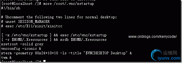

VNC会在用户根目录($HOME)下的".vnc"文件夹下生成一系列文件。其中passwd为vnc用户密码文件,由vncpasswd生成。其他的都由vnc初次启动时生成,xstartup为VNC客户端连接时启动的脚本
5、配置xstartup文件
如下所示,将下面紫红色的部分注释取消。
#!/bin/sh
# Uncomment the following two lines for normal desktop:
unset SESSION_MANAGER
exec /etc/X11/xinit/xinitrc
[ -x /etc/vnc/xstartup ] && exec /etc/vnc/xstartup
[ -r $HOME/.Xresources ] && xrdb $HOME/.Xresources
xsetroot -solid grey
vncconfig -iconic &
xterm -geometry 80x24+10+10 -ls -title "$VNCDESKTOP Desktop" &
twm &
