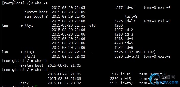

17.who
1)命令格式:
  who [OPTION]... [ FILE | ARG1 ARG2 ]
2)命令功能:
  show who is logged on
  3)命令参数:
  -a, --all
  same as -b -d --login -p -r -t -T -u
  -b, --boot
  time of last system boot
  -d, --dead
  print dead processes

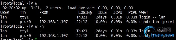

18.w
1)命令格式:
w - [husfV] [user]
2)命令功能:
Show who is logged on and what they are doing.
3)命令参数:
-h 不输入标题
