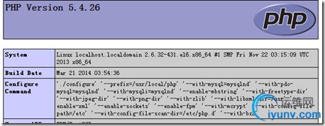

  4、在/usr/html新建index.php的测试页面,测试php是否能正常工作:
#vim index.php
  <?php
phpinfo();

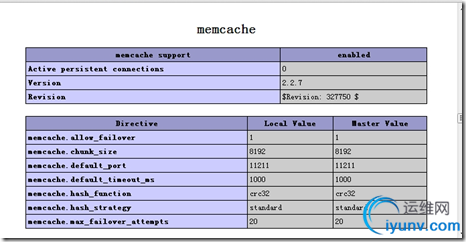

  七、配置mamched
  mamched是一个缓存服务器,高性能、分布式内存对象缓存系统,可应用各种需要缓存的场景,其主要目的是通过降低对Database的访问来加速web应用程序。它是一个基于内存的“键值对”存储,用于存储数据库调用、API调用或页面引用结果的直接数据,如字符串、对象等。
  这里,我们将mamched放到单独的服务器上进行部署172.16.37.250服务器上,这里使用编译安装
  1、编译安装
  # tar xf memcache-2.2.7.tgz
  # cd memcache-2.2.7.tgz
  # ./configure --prefix=/usr/local/memcached --with-libevent=/usr/local/libevent
# make && make install
  2、提供服务脚本
  v im  /etc/init.d/memcached
  #!/bin/bash
# Init file for memcached
# chkconfig: - 86 14
# description: Distributed memory caching daemon
# processname: memcached
# config: /etc/sysconfig/memcached
  . /etc/rc.d/init.d/functions
  ## Default variables
PORT=&quot;11211&quot;
USER=&quot;nobody&quot;
MAXCONN=&quot;1024&quot;
CACHESIZE=&quot;64&quot;
OPTIONS=&quot;&quot;
  RETVAL=0
prog=&quot;/usr/local/memcached/bin/memcached&quot;
desc=&quot;Distributed memory caching&quot;
lockfile=&quot;/var/lock/subsys/memcached&quot;
  start() {
        echo -n $&quot;Starting $desc (memcached): &quot;
        daemon $prog -d -p $PORT -u $USER -c $MAXCONN -m $CACHESIZE -o &quot;$OPTIONS&quot;
        RETVAL=$?
        [ $RETVAL -eq 0 ] && success && touch $lockfile || failure
        echo
        return $RETVAL
  stop() {
        echo -n $&quot;Shutting down $desc (memcached): &quot;
        killproc $prog
        RETVAL=$?
        [ $RETVAL -eq 0 ] && success && rm -f $lockfile || failure
        echo
        return $RETVAL
  restart() {
        stop
        start
  reload() {
        echo -n $&quot;Reloading $desc ($prog): &quot;
        killproc $prog -HUP
        RETVAL=$?
        [ $RETVAL -eq 0 ] && success || failure
        echo
        return $RETVAL
  case &quot;$1&quot; in
  start)
        start
  stop)
        stop
  restart)
        restart
  condrestart)
        [ -e $lockfile ] && restart
        RETVAL=$?
  reload)
        reload
  status)
        status $prog
        RETVAL=$?
        echo $&quot;Usage: $0 {start|stop|restart|condrestart|status}&quot;
        RETVAL=1
esac
  exit $RETVAL
添加系统自动启动。
  # chkconfig --add memcached
  启动服务
# service memcached start
  通过phpinfo()查看是否启动成功。
  如果有上述显示模块,表示成功。

  3、验证是否配置成功
  使用测试页测试
  <?php
$mem = new Memcache;
$mem->connect(&quot;172.16.37.250&quot;, 11211)  or die(&quot;Could not connect&quot;);
  $version = $mem->getVersion();
echo &quot;Server's version: &quot;.$version.&quot;<br/>\n&quot;;
  $mem->set('hellokey', 'Hello World', 0, 600) or die(&quot;Failed to save data at the memcached server&quot;);
echo &quot;Store data in the cache (data will expire in 600 seconds)<br/>\n&quot;;
  $get_result = $mem->get('hellokey');
echo &quot;$get_result is from memcached server.&quot;;
  红色部分为memcache所在服务器IP地址。
  如果出现上述页面,说明配置成功。
