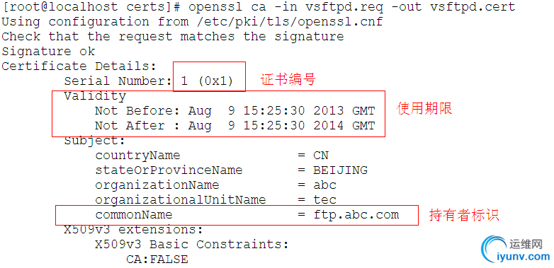

12.[root@localhostCA]#opensslreq-new-keyprivate/cakey.pem-x509-outcacert.pem自己给自己颁发证书
13.为服务器颁发证书
14.[root@localhostCA]#mkdir-pv/etc/vsftpd/certs
15.[root@localhostCA]#cd/etc/vsftpd/certs/
16.[root@localhostcerts]#opensslgenrsa1024>vsftpd.key
17.[root@localhostcerts]#opensslreq-new-keyvsftpd.key-outvsftpd.req
18.[root@localhostcerts]#opensslca-invsftpd.req-outvsftpd.cert

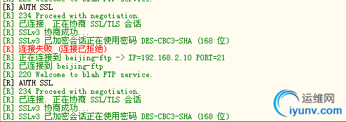

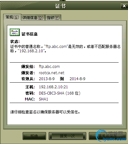

19.[root@localhostcerts]#vim/etc/vsftpd/vsftpd.conf证书的捆绑
20.图3
21.serviceftpdrestart
22.利用flashfxp(参考百度搜索)
23.图7
24.图8
25.图9
26.图10
