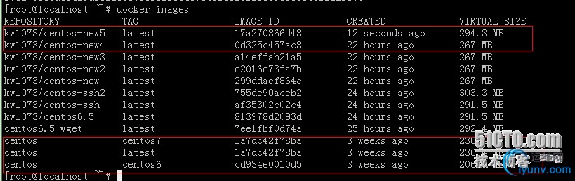

17a270866d48429d582aae50b6f3183a4e76c5b4813b1f6e96b5684cb222b100#####查看当前的镜像########
[root@localhost ~]# docker images
