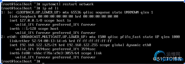

  ④修改虚拟机网卡配置
[root@localhost ~]# vi /etc/sysconfig/network-scripts/ifcfg-eth0
TYPE=Ethernet
BOOTPROTO=static
NAME=eth0
ONBOOT=yes
IPADDR=192.168.56.111
NETMASK=255.255.255.0
GATEWAY=192.168.56.2
[root@localhost ~]# systemctl restart network
