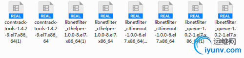

  需要用到这些rpms包: DSC0001.png
  附件提供了:
  conntrack-tools-1.4.2-9.el7.x86_64(1)
  libnetfilter_cthelper-1.0.0-8.el7.x86_64(1)
  libnetfilter_cttimeout-1.0.0-6.el7.x86_64(1)
  libnetfilter_queue-1.0.2-1.el7.x86_64(1)
