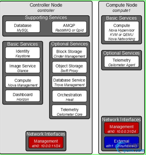

  Based on OpenStack Icehouse release
  nova controller node setup
  1. Install and Configure OpenStack Compute Service (Nova)

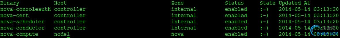

  to check mounted nova computer node:
  nova-manage service list
  nova image-list

  on controller node to check node1 status:
