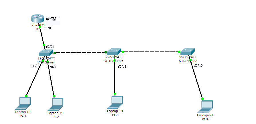

实验拓扑:
一、配置VTP协议

设置PC的ip
  • PC1
IP:192.168.1.10/24
网关:192.168.1.1
  • PC2
IP:192.168.1.20/24
网关:192.168.1.1
  • PC3
IP:192.168.20.10/24
网关:192.168.20.1
  • PC4
IP:192.168.1.30/24
网关:192.168.1.1
设置单臂路由
  • f0/0.1接口指定为802.1q协议,vlan 10
R1(config)#int f0/0
R1(config-if)#no shut
%LINK-5-CHANGED: Interface FastEthernet0/0, changed state to up
%LINEPROTO-5-UPDOWN: Line protocol on Interface FastEthernet0/0, changed state to up
R1(config-if)#int f0/0.1
R1(config-subif)#
%LINK-5-CHANGED: Interface FastEthernet0/0.1, changed state to up
%LINEPROTO-5-UPDOWN: Line protocol on Interface FastEthernet0/0.1, changed state to up
R1(config-subif)#encaps
R1(config-subif)#encapsulation dot1q 10
R1(config-subif)#ip add 192.168.1.1 255.255.255.0
R1(config-subif)#exi
R1(config)#
  • f0/0.2接口指定为802.1q协议,vlan 20
R1(config)#int f0/0
R1(config-if)#int f0/0.2
%LINK-5-CHANGED: Interface FastEthernet0/0.2, changed state to up
%LINEPROTO-5-UPDOWN: Line protocol on Interface FastEthernet0/0.2, changed state to up
R1(config-subif)#
R1(config-subif)#encapsulation dot1q 20
R1(config-subif)#ip add 192.168.20.1 255.255.255.0
R1(config)#
  • 设置Server交换机与路由器相连接口为Trunk模式
Server(config)#int f0/24
Server(config-if)#sw
Server(config-if)#switchport mode trunk
%LINEPROTO-5-UPDOWN: Line protocol on Interface FastEthernet0/24, changed state to down
%LINEPROTO-5-UPDOWN: Line protocol on Interface FastEthernet0/24, changed state to up
Server(config-if)#
测试主机的连通性
PC>ping 192.168.1.30
Pinging 192.168.1.30 with 32 bytes of data:
Reply from 192.168.1.30: bytes=32 time=56ms TTL=128
Reply from 192.168.1.30: bytes=32 time=19ms TTL=128
Reply from 192.168.1.30: bytes=32 time=18ms TTL=128
Reply from 192.168.1.30: bytes=32 time=17ms TTL=128
Ping statistics for 192.168.1.30:
    Packets: Sent = 4, Received = 4, Lost = 0 (0% loss),
Approximate round trip times in milli-seconds:
    Minimum = 17ms, Maximum = 56ms, Average = 27ms
PC1可以成功ping通PC4,说明vlan划分设置成功!!
