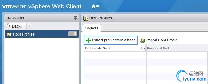

  To Create Host profile, Login to vCenter Server using vSphere Web Client. Click on Host Profile icon on the home page of the vSphere Web Client. Click “Extracted Profile from a host” to extract a profile from ESXi host with the known root password.

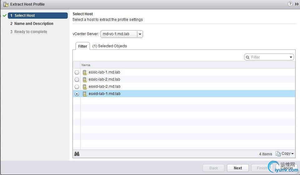

  Select the ESXi host from which you want to extract all the settings from. Click Next.
