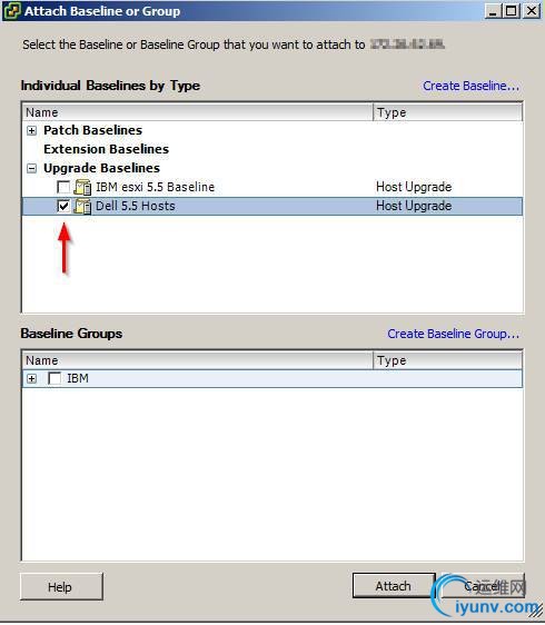

  •   Go to the Hosts and Clusters view and select the host you want to upgrade first and then select the “Update Manager” tab, then click on the “Attach” link so that we can attach our new Baseline to this host.
  •   Now select the newly created Baseline you created during the upgrade, then click on “Attach“. In this example, since this is a Dell host I named the baseline “Dell 5.5 Hosts”.

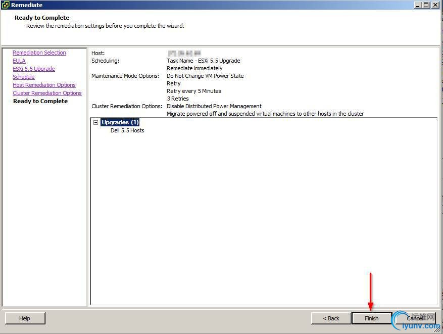

  •   The only thing left to do now is to look over the confirmation and then click on “Finish“. VUM will then start the upgrade process which can take some time so go get a coffee or in my case, water and wait.
  •   Once finished you’re host will be running ESXi 5.5. It’s as easy as that!
