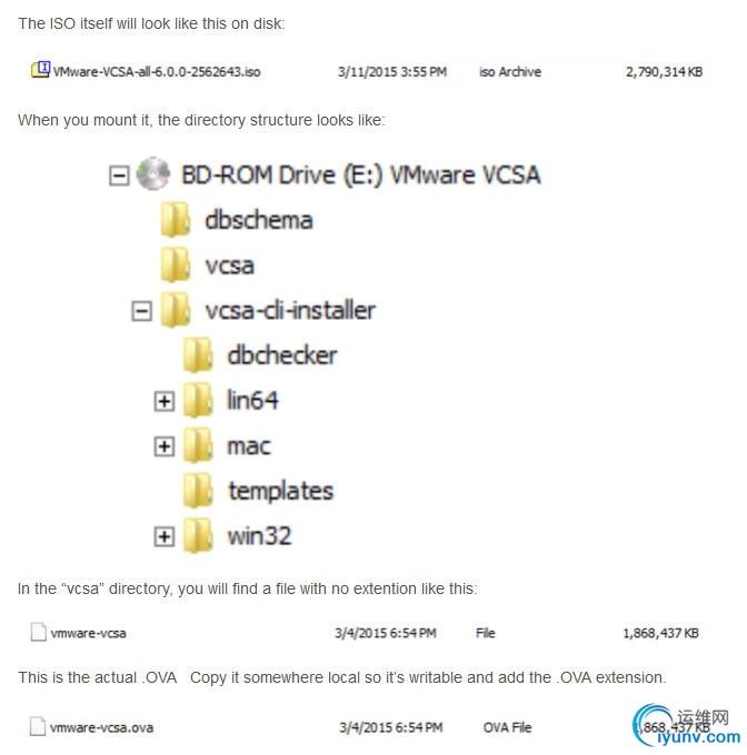

Step 1 - Download the VCSA 6 which is available as an ISO
Step 2 - Extract the contents of the ISO and add the .ova extension to following file located in vcsa/vmware-vcsa (this is the VCSA OVA)

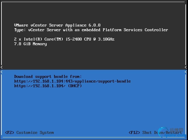

Step 5 - Once you have saved your changes, go ahead and power on the VCSA. At this point, the guestinfo properties that you just added will be read in by VMware Tools as the VCSA is booting up and the configuration will begin. Depending on the speed of your hardware, hopefully in a very short amount of time you will have a fully configured VCSA that is ready for your evaluation and testing.
  Notes:
1.using F2 to customize system
2.using /opt/vmware/share/vami/vami_config_net to config network from CLI

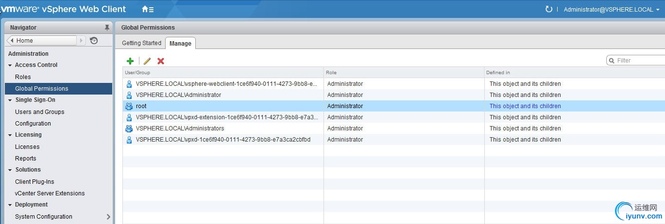

  Step 6 - login with administrator@vsphere.local to grant root permission and etc.
