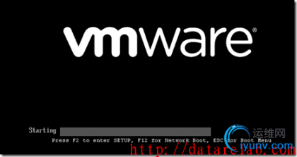

  Now, your normal Virtualized vSphere host in VMware Workstation uses a BIOS.  Notice this in the startup screen when you boot the VM:

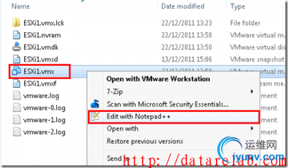

  Power down your Virtual ESXi host.  Go to the location where the vmx file is stored and edit it with your favorite editor.
  Add the line firmware = “efi” somewhere in the vmx file.
