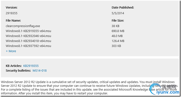

  首先怀疑的是with Update……
  因为查KB,有一篇文章介绍了MS14-046之后的两个补丁,如果没有安装.Net Framework 3.5,由于meatdata的改变,就不再能够“初次”安装。具体描述参考:
  Enabling the Microsoft .NET Framework 3.5 optional Windows feature on Windows 8, Windows Server 2012, Windows 8.1, or Windows Server 2012 R2 may fail after you install security update 2966827 or 2966828
  http://support2.microsoft.com/kb/3002547
  MS14-046: Description of the security update for the .NET Framework 3.5 on Windows 8 and Windows Server 2012: August 12, 2014
  http://support2.microsoft.com/kb/2966827
  MS14-046: Description of the security update for the .NET Framework 3.5 on Windows 8.1 and Windows Server 2012 R2: August 12, 2014
  http://support2.microsoft.com/kb/2966828
  仔细想了想,不太对啊。Update对应的安全通告号码,KB号都在这个补丁之前啊:
  应该不是这个问题……难道是介质上的NetFx3源文件有问题?
