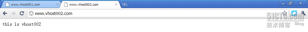

配置完成后重启nginx服务
[iyunv@server nginx]# ps aux |grep nginx
root      3581  0.0  0.7  57400  1740 ?        Ss   07:37   0:00 nginx: master process /usr/local/nginx/sbin/nginx
www       3582  0.0  1.1  57824  2664 ?        S    07:37   0:00 nginx: worker process
root      3607  0.0  0.3 103232   864 pts/0    S+   08:01   0:00 grep nginx
[iyunv@server nginx]# kill -HUP 3581
[iyunv@server ~]# mkdir /usr/local/nginx/html/vhost001
[iyunv@server ~]# mkdir /usr/local/nginx/html/vhost002
[iyunv@server ~]# echo "this is vhost001" > /usr/local/nginx/html/vhost001
[iyunv@server ~]# echo "this is vhost002" > /usr/local/nginx/html/vhost002
打开浏览器,测试效果:
