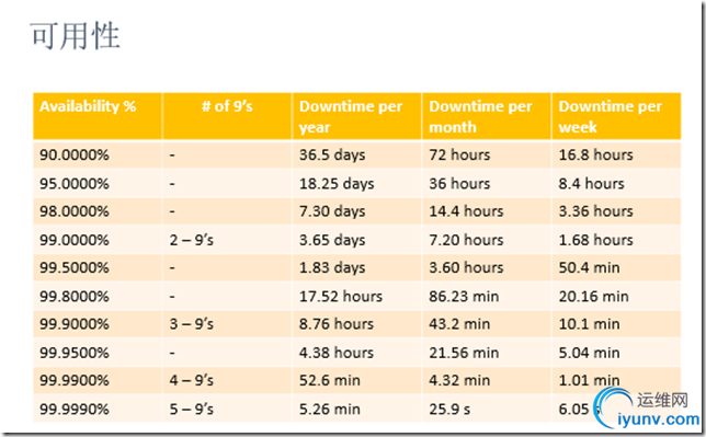

  下面是一个可用性的图例,在不同的可用性标准下,每年允许的宕机时间,每月允许的宕机时间和每周允许的宕机时间。

  The Myth of the 9’s of Availability
  It is common for organizations to state that they provide a number of 9’s of availability when referring to their environments. The truth is often much different than what is advertised and even then, it is often meant for only operating hours or not counting planned downtime, which may not be clearly documented in the SLA. Committing to only business hours and unplanned outages is acceptable as long as it is supported by what is documented in the SLA.
  Note: Microsoft recommends that the 9’s of availability are based on agreed upon hours of operation, which should be clearly stated in the SLA.
  The table on the slide above outlines the 9’s of availability and what actually means to have that level of uptime. Based on the table above, if an organization claims to have 3 – 9’s of availability and they are a 24/7 operation, they can only have 8.76 hours of downtime per year.
