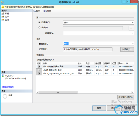

  The “General” page can be used to specify the required information about the target and source databases needed for a database restore operation.  This page is split into three different sections “Source”, “Destination”, and “Restore Plan.”
  Source – This section contains areas where it can be specified the location of the backup sets for the database and which backup sets are to be restored.
  ?Database – Use the drop-down list box to select the database to restore.
  ?Device –  Used to point to specific backup files or devices.  Note: This is required if the database backup was taken on a different instance of SQL Server. Up to 64 devices can be selectedthat belong to a single media set.(注解:如果要从备份设备还原,必须之前创建了备份设备并且将备份存放在备份设备中,关于如何创建备份设备,可参考我之前的笔记:http://543925535.blog.51cto.com/639838/1426808)
  ?Database – Select the database name from which the backups should be restored from the dropdown list.
  Destination – This section is used to>  ?Database - Enter the database to restore in the list.

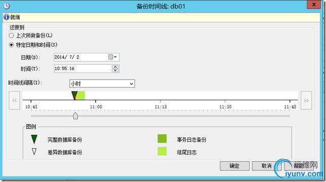

  ?Restore to - The “Restore to” box will be set "To the last backup taken" by default.  You can also click Timeline to show the Backup Timeline dialog box, which displays the database backup history in the form of a timeline. (注解:这里可以指定将数据库还原到哪个时间点,我们双击下图中时间轴上的数据库备份的图例,就可以准备定位到对应的时间点)
  Restore Plan
  Backup site to restore - Displays the backup sets available for the specified location. Each backup set, the result of a single backup operation, is distributed across all of the devices in the media set.  By default, a recovery plan is suggested to achieve the goal of the restore operation that is based on the selection of the required backup sets.  SQL Server Management Studio (SSMS)uses the backup history in msdb to> if any exist. Under the full recovery model, the restore plan then selects all subsequent log backups.
  To override the suggested recovery plan, you can change the selections in the grid.  Any backups that depend on a deselected backup are deselected automatically.

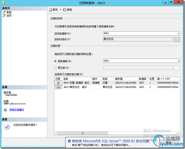

  我们可以对比看一下SQL server 2008R2的还原数据库界面,下图是2008R2的还原界面。
  SQL server 2008R2还原数据库的向导界面没有配置时间线的地方。

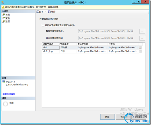

  在SQL server 2012的还原数据库向导中,多出了一个“文件”选项卡“,可以将数据库文件还原到新的位置,如图。

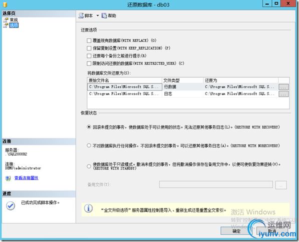

  在SQL server 2008R2中,还原为是集中在”选项“界面中的,下图。

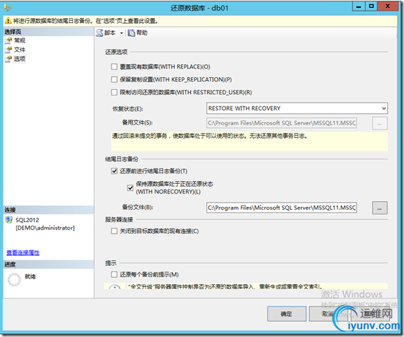

  对比上图,我们可以看到在SQL server 2012的选项界面,多了一个结尾日志备份,也就是说在还原之前会做一遍结尾日志的备份操作,同时我们可以选择是否在还原时关闭所有到这个数据库的连接,如图。
  关于尾部日志还原的实际应用,可以参考我的笔记:http://543925535.blog.51cto.com/639838/1427218
