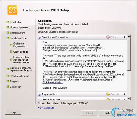

  While trying to install Exchange 2010, the process fails with the following error.
  Organization Preparation     Failed
  Error:
  The following error was generated when "$error.Clear();
  install-ExchangeSchema -LdapFileName ($roleInstallPath + "Setup\Data\"+$RoleSchemaPrefix + "schema0.ldf")
  " was run: "There was an error while running 'ldifde.exe' to import the schema file 'C:\Windows\Temp\ExchangeSetup\Setup\Data\PostWindows2003_schema0.ldf'. The error code is: 8224. More details can be found in the error file: 'C:\Users\administrator.{your-domain}\AppData\Local\Temp\2\ldif.err'".

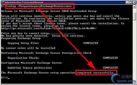

  5. ONLY do this if you have Exchange 2003 already! Run the following command, (If no Exchange 2003 present, skip to the next step).
  Setup /PrepareLegacyExchangePermissions

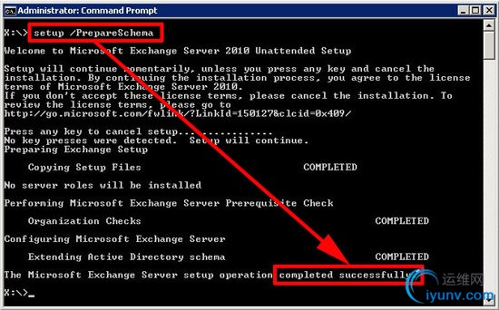

  6. Run the following command:
  Setup /PrepareSchema

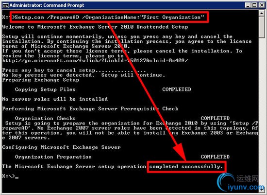

  7. Run the following command:
  Setup /PrepareAD
  Note: At this point it may fail, and say it requires an organization name, (it will do this if it finds no existing container in Active Directory).
  Error
  Exchange organization name is required for this mode.  To specify an organization name, use the /organizationName parameter.
  If that is the case, then run the following command:
  Setup /PrepareAD /OrganizationName:"Your required org name"

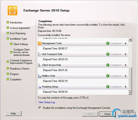

  8. Now try and install Exchange 2010, and it should progress without the original error.
