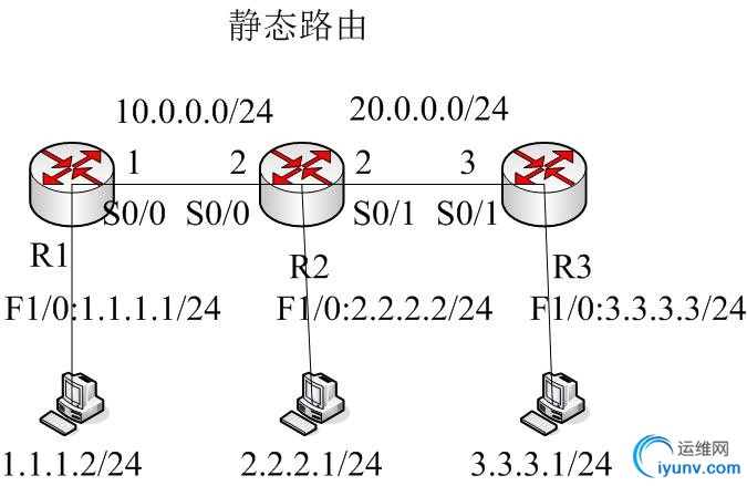

  现在为大家展示一下静态路由的简单配置过程。(*^__^*) 嘻…其中在最后的测试过程中,不免有好多的疑问,希望各位能够多多指教,谢谢了~~
  废话不多说,开整,拓扑图如下:
  Router1 S0/0 <----> Router2 S0/0
  Router2 S0/1 <----> Router3 S0/1
  Router1 F1/0 <----> VPCS V0/1
  Router2 F1/0 <----> VPCS V0/2
  Router3 F1/0 <----> VPCS V0/3
  配置静态路由的命令为“ip route” ,命令的格式如下:
  ip route 目的网络 掩码 { 网关地址 | 接口 }
  例子:ip route 10.0.0.0 255.255.255.0  s0/0
  例子:ip route 10.0.0.0 255.255.255.0  12.12.12.2
  进入实战:
  R1配置:
  R1(config)#int s0/0
  R1(config-if)#ip add 10.0.0.1 255.255.255.0
  R1(config-if)#no shut
  R1(config-if)#exit
  R1(config)#int f1/0
  R1(config-if)#ip add 1.1.1.1 255.255.255.0
  R1(config-if)#exit
  R1(config)#ip route 2.2.2.0 255.255.255.0 s0/0
  R1(config)#ip route 3.3.3.0 255.255.255.0 10.0.0.2

  R2配置:
  R2(config)#int f1/0
  R2(config-if)#ip add 2.2.2.2 255.255.255.0
  R2(config-if)#no shut
  R2(config-if)#exit
  R2(config)#int s0/0
  R2(config-if)#ip add 10.0.0.2 255.255.255.0
  R2(config-if)#clock rate 128000
  R2(config-if)#exit
  R2(config)#int s0/1
  R2(config-if)#ip add 20.0.0.2 255.255.255.0
  R2(config-if)#exit
  R2(config)#ip route 1.1.1.0 255.255.255.0 s0/0
  R2(config)#ip route 3.3.3.0 255.255.255.0 s0/1

  R3配置:
  R3(config)#int s0/1
  R3(config-if)#ip add 20.0.0.3 255.255.255.0
  R3(config-if)#no shut
  R3(config-if)#exit
  R3(config)#int f1/0
  R3(config-if)#ip add 3.3.3.3 255.255.255.0
  R3(config-if)#exit
  R3(config)#ip route 1.1.1.0 255.255.255.0 s0/1
  R3(config)#ip route 2.2.2.0 255.255.255.0 s0/1
  R3(config)#end

  测试路由连通性:
  R1
  R1#ping 1.1.1.1
  Type escape sequence to abort.
  Sending 5, 100-byte ICMP Echos to 1.1.1.1, timeout is 2 seconds:
  Success rate is 100 percent (5/5), round-trip min/avg/max = 1/2/4 ms
  //ping 1.1.1.1通
  R1#ping 1.1.1.2
  Sending 5, 100-byte ICMP Echos to 1.1.1.2, timeout is 2 seconds:
  Success rate is 100 percent (5/5), round-trip min/avg/max = 32/35/48 ms
  //ping 1.1.1.2通
  R1#ping 10.0.0.1
  Sending 5, 100-byte ICMP Echos to 10.0.0.1, timeout is 2 seconds:
  Success rate is 100 percent (5/5), round-trip min/avg/max = 60/68/92 ms
  //ping 10.0.0.1通
  R1#ping 10.0.0.2
  Sending 5, 100-byte ICMP Echos to 10.0.0.2, timeout is 2 seconds:
  Success rate is 100 percent (5/5), round-trip min/avg/max = 28/44/76 ms
  //ping 10.0.0.2通
  R1#ping 20.0.0.2
  Sending 5, 100-byte ICMP Echos to 20.0.0.2, timeout is 2 seconds:
  Success rate is 0 percent (0/5)
  //ping 20.0.0.2不通,为什么呢?
  R1#ping 20.0.0.3
  Sending 5, 100-byte ICMP Echos to 20.0.0.3, timeout is 2 seconds:
  //ping 20.0.0.3不通,为什么呢?
  R1#ping 2.2.2.2
  Sending 5, 100-byte ICMP Echos to 2.2.2.2, timeout is 2 seconds:
  Success rate is 100 percent (5/5), round-trip min/avg/max = 32/40/60 ms
  //ping 2.2.2.2通
  R1#ping 2.2.2.1
  Sending 5, 100-byte ICMP Echos to 2.2.2.1, timeout is 2 seconds:
  Success rate is 100 percent (5/5), round-trip min/avg/max = 20/42/60 ms
  //ping 2.2.2.1通
  R1#ping 3.3.3.3
  Sending 5, 100-byte ICMP Echos to 3.3.3.3, timeout is 2 seconds:
  //ping 3.3.3.3不通,为什么呢?
  R1#ping 3.3.3.1
  Sending 5, 100-byte ICMP Echos to 3.3.3.1, timeout is 2 seconds:
  //ping 3.3.3.1不通,为什么呢?
  R2*(全通)

  Success rate is 100 percent (5/5), round-trip min/avg/max = 28/35/48 ms
  R2#ping 10.0.0.2
  Success rate is 100 percent (5/5), round-trip min/avg/max = 84/100/124 ms
  R2#ping 20.0.0.2
  Success rate is 100 percent (5/5), round-trip min/avg/max = 60/63/68 ms
  R2#ping 20.0.0.3
  Success rate is 100 percent (5/5), round-trip min/avg/max = 32/41/68 ms
  R2#ping 2.2.2.2
  R2#ping 2.2.2.1
  Success rate is 100 percent (5/5), round-trip min/avg/max = 12/22/36 ms
  R2#ping 3.3.3.3
  Success rate is 100 percent (5/5), round-trip min/avg/max = 32/44/48 ms
  R2#ping 3.3.3.1
  Success rate is 100 percent (5/5), round-trip min/avg/max = 48/59/76 ms
  综上所述,十个节点全通!
  R3
  R3#ping 1.1.1.1
  //ping 1.1.1.1不通,为什么呢?
  R3#ping 1.1.1.2
  //ping 1.1.1.2不通,为什么呢?
  R3#ping 10.0.0.1
  //ping 10.0.0.1不通,为什么呢?
  R3#ping 10.0.0.2
  //ping 10.0.0.2 不通,为什么呢?
  R3#ping 2.2.2.2
  Success rate is 100 percent (5/5), round-trip min/avg/max = 28/38/68 ms
  //R3#ping 2.2.2.2通
  R3#ping 2.2.2.1
  Success rate is 100 percent (5/5), round-trip min/avg/max = 32/49/64 ms
  //ping 2.2.2.1通
  R3#ping 20.0.0.2
  Success rate is 100 percent (5/5), round-trip min/avg/max = 24/34/44 ms
  //ping 20.0.0.2通
  R3#ping 20.0.0.3
  Success rate is 100 percent (5/5), round-trip min/avg/max = 60/68/80 ms
  /ping 20.0.0.3通
  R3#ping 3.3.3.3
  //ping 3.3.3.3通
  R3#ping 3.3.3.1
  Success rate is 100 percent (5/5), round-trip min/avg/max = 16/31/48 ms
  //ping 3.3.3.1通

  至此实验结束,各PC间都通,但为什么中途的路由节点却不通呢?想不明白, 希望高手赐教~~先谢谢了~
