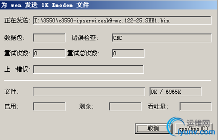

switch:copy xmodem:  flash:image_filename.bin    Eg:    DSC0000.png     出现如下提示:    Begin the Xmodem or Xmodem-1K transfer now...    DSC0001.png     系统提示不断出现C这个字母就可以开始传文件了  7. 点击超级终端菜单:传送——发送文件,在协议选项中选择Xmodem 或者1K  Xmodem协议,然后选择ios的影像文件(*.bin),开始传送;
传送完毕后提示:  File "xmodem:" successfully copied to "flash:c3550-ipservicesk9-mz.122-25.SEE1.bin"
  switch:
