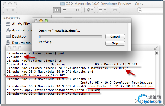

  5) Double click OS X 10.9 Mavericks DMG file and let it mount. A new volume ( ‘OS X Mavericks 10.9 DP1” as of now) will appear under volumes once it’s mounted.
  We need to open (mount) InstallESD.dmg file now. You can run the following terminal command from inside OS X Mavericks 10.9 DP1.

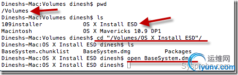

  6) Mount BaseSystem.dmg which is inside the volume mounted in previous step.
  Run following command from inside newly mounted volume called ‘OS X Install ESD’.
  Wait for some time to get over of mounting BaseSystem.
