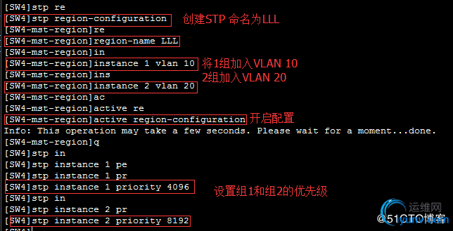

  在SW4上创建STP,命名为LLL
  将VLAN 10加入一组,优先级设置为4096;
  将VLAN 20加入二组,优先级设置为8192;

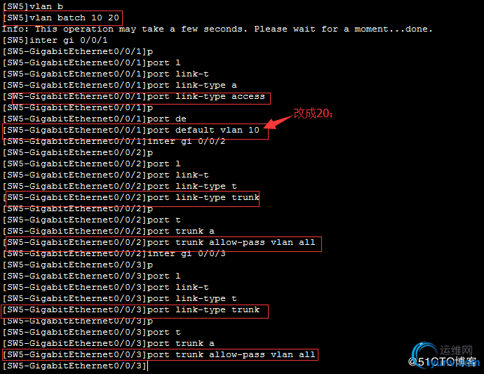

  3.配置SW5
  在SW5上创建VLAN 10 20;
  把gi 1接口配置为access链路,加入VLAN 20
  把gi 2接口配置为trunk链路,允许所有VLAN通过
  把gi 3接口配置为trunk链路,允许所有VLAN通过

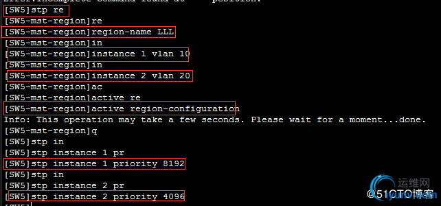

  在SW5上创建STP,命名为LLL
  [SW5]stp region-configuration                 创建STP
  [SW5-mst-region]region-name LLL               命名位 LLL
  [SW5-mst-region]instance 1 vlan 10         将1组加入VLAN 10
  [SW5-mst-region]instance 2 vlan 20              将2组加入VLAN 20
  [SW5-mst-region]active region-configuration        开启配置
  [SW5]stp instance 1 priority 8192               配置1组优先级
  [SW5]stp instance 2 priority 4096               配置2组优先级

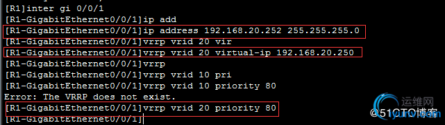

  [R1]inter gi 0/0/1
  [R1-GigabitEthernet0/0/1]ip address 192.168.20.252 255.255.255.0   配置GI 0/0/1接口的物理IP
  [R1-GigabitEthernet0/0/1]vrrp vrid 20 virtual-ip 192.168.20.250    配置VRRP,虚拟IP
  [R1-GigabitEthernet0/0/1]vrrp vrid 20 priority 80             配置vrrp的优先级为80

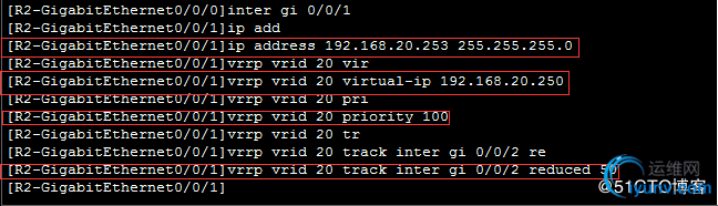

  [R2-GigabitEthernet0/0/1]ip address 192.168.20.253 255.255.255.0      配置物理接口IP
  [R2-GigabitEthernet0/0/1]vrrp vrid 20 virtual-ip 192.168.20.250       创建VRRP,配置虚拟网关IP
  [R2-GigabitEthernet0/0/1]vrrp vrid 20 priority 100               设置VRRP的优先级100
  [R2-GigabitEthernet0/0/1]vrrp vrid 20 track inter gi 0/0/2 reduced 50    链路跟踪

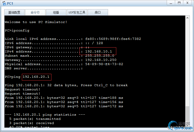

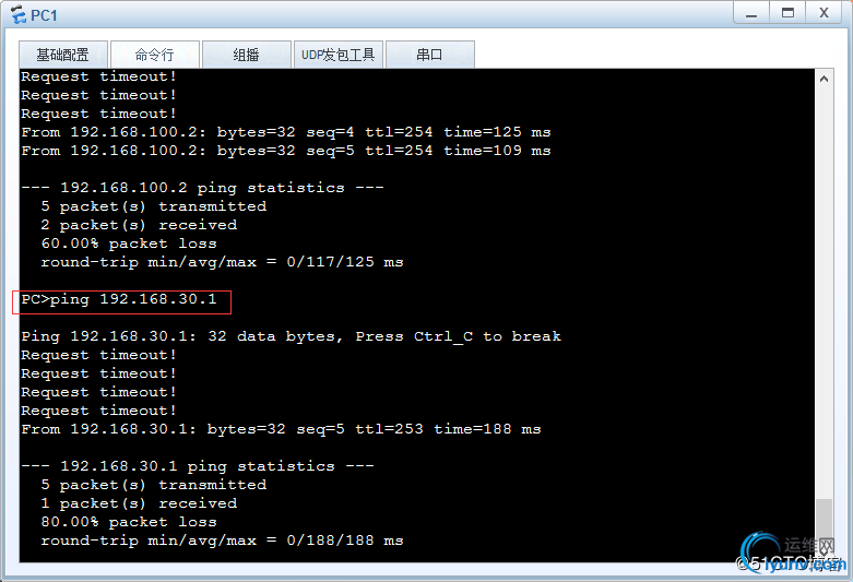

  验证此步骤做完PC1与PC2,PC4能互通
  第三部分: 配置步骤
  •   SW1端口默认开启,不用做任何配置
  •   配置R4
  [R4]inter gi 0/0/0
  [R4-GigabitEthernet0/0/0]ip address 192.168.100.2 255.255.255.0      配置gi 0接口ip
  [R4-GigabitEthernet0/0/0]inter gi 0/0/1
  [R4-GigabitEthernet0/0/1]ip address 192.168.30.254 255.255.255.0     配置gi 1接口IP
  [R4-GigabitEthernet0/0/1]ospf 1 router-id 4.4.4.4               创建OSPF 1
  [R4-ospf-1]area 30
  [R4-ospf-1-area-0.0.0.30]network 192.168.30.0 0.0.0.255        在OSPF 1中area 30宣告网段
  [R4-ospf-1-area-0.0.0.30]network 192.168.100.0 0.0.0.255
  验证 测试全网互通
  用PC1 PC2分别PING server主机 192.168.30.1
