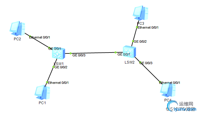

  sw1
  <Huawei>dis current
  sysname Huawei
  vlan batch 2 to 3
  cluster enable
  ntdp enable
  ndp enable
  drop illegal-mac alarm
  diffserv domain default
  drop-profile default
  aaa
  authentication-scheme default
  authorization-scheme default
  accounting-scheme default
  domain default
  domain default_admin
  local-user admin password simple admin
  local-user admin service-type http
  <Huawei>
  SW2
  sysname Huawei
  vlan batch 2 to 3
  cluster enable
  ntdp enable
  ndp enable
  aaa
  domain default
  interface Vlanif1
  interface MEth0/0/1
  interface GigabitEthernet0/0/1
  port link-type trunk
  port trunk allow-pass vlan 2 to 3
  interface GigabitEthernet0/0/2
  port link-type access
  port default vlan 2
  interface GigabitEthernet0/0/3
  port default vlan 3
  interface GigabitEthernet0/0/4
  interface GigabitEthernet0/0/5
  interface GigabitEthernet0/0/6
  interface GigabitEthernet0/0/7
  interface GigabitEthernet0/0/8
  interface GigabitEthernet0/0/9
  interface GigabitEthernet0/0/10
  interface GigabitEthernet0/0/11
  interface GigabitEthernet0/0/12
  interface GigabitEthernet0/0/13
  interface GigabitEthernet0/0/14
  interface GigabitEthernet0/0/15
  interface GigabitEthernet0/0/16
  interface GigabitEthernet0/0/17
  interface GigabitEthernet0/0/18
  interface GigabitEthernet0/0/19
  interface GigabitEthernet0/0/20
  interface GigabitEthernet0/0/21
  interface GigabitEthernet0/0/22
  interface GigabitEthernet0/0/23
  interface GigabitEthernet0/0/24
  interface NULL0
  user-interface con 0
  user-interface vty 0 4
  return
