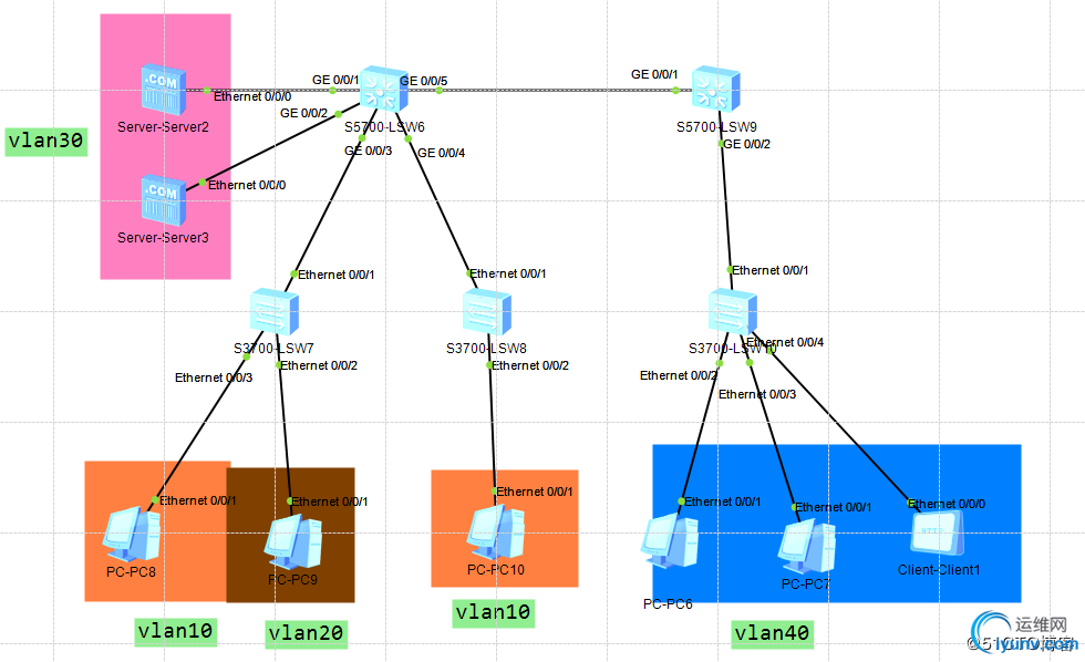

  使用eNSP搭建实验环境
  一.pc机192.168.10.254 网关192.168.10.254 以此为论推
  二:sw7配置(端口加vlan )
  [Huawei]vlan batch 10 20
  [Huawei]int eth0/0/3
  Huawei-Ethernet0/0/3]undo shutdown
  [Huawei-Ethernet0/0/3]port link-type access
  [Huawei-Ethernet0/0/3]port default valn 10
  [Huawei]int eth 0/0/2
  [Huawei-Ethernet0/0/2]port   link-type access
  [Huawei-Ethernet0/0/2]port default valn 20
  [Huawei-Ethernet0/0/1]int eth 0/0/1
  [Huawei-Ethernet0/0/1]port link-type trunk
  [Huawei-Ethernet0/0/1]port trunk allow-pass valn all
  三:sw8配置
  [sw8]vlan 10
  [sw8]int eth0/0/2
  [sw8-Ethernet0/0/2]undo shutdown
  [sw8-Ethernet0/0/2]port link-type access
  [sw8-Ethernet0/0/2]port default vlan 10
  [sw8]int eth0/0/1
  [sw8-Ethernet0/0/1]port link-type trunk
  [sw8-Ethernet0/0/1]port trunk   allow-pass vlan all
  三:sw10配置
  [sw10]vlan 40
  [sw10-vlan40]int eth0/0/2
  [sw10-Ethernet0/0/2]port   link-type a
  [sw10-Ethernet0/0/2]port   link-type access
  [sw10-Ethernet0/0/2]port default vlan 40
  [sw10-Ethernet0/0/2]undo shutdown
  Info: Interface Ethernet0/0/2 is   not shutdown.
  [sw10-Ethernet0/0/2]q
  [sw10]int eth0/0/3
  [sw10-Ethernet0/0/3]undo shutdown
  [sw10-Ethernet0/0/3]port link-type access
  [sw10-Ethernet0/0/3]port default vlan 40
  [sw10-Ethernet0/0/4]undo shutdown
  [sw10-Ethernet0/0/4]port link-type access
  [sw10-Ethernet0/0/4]port   default vlan 40
  [sw10]int eth0/0/1
  [sw10-Ethernet0/0/1]port link-type trunk
  [sw10-Ethernet0/0/1]port trunk   allow-pass vlan all
  [sw10-Ethernet0/0/1]undo   shutdown
  四,sw9配置(sw9.10trunk)
  [sw9]vlan batch 30 40 50
  Info: This operation may take a   few seconds. Please wait for a moment...done.
  [sw9]int vlan 30
  [sw9-Vlanif30]undo shutdown
  Info: Interface Vlanif30 is not   shutdown.
  [sw9-Vlanif30]ip add   192.168.30.254 24
  [sw9-Vlanif30]q
  [sw9]int vlan 50
  [sw9-Vlanif50]ip add 192.168.50.2   24
  [sw9-Vlanif50]q
  [sw9]int vlan 40
  [sw9-Vlanif40]undo shutdown
  [sw9-Vlanif40]ip add 192.168.40.254 24
  [sw9-Vlanif40]q
  [sw9]int g0/0/1
  [sw9-GigabitEthernet0/0/1]undo shutdown
  [sw9-GigabitEthernet0/0/1]port link-type trunk
  [sw9-port-group-trunk]port trunk allow-pass vlan all
  [sw9-port-group-trunk]q
  [sw9]int g0/0/2
  [sw9-GigabitEthernet0/0/2]port link-type trunk
  [sw9-GigabitEthernet0/0/2]port trunk allow-pass vlan all
  [sw9-GigabitEthernet0/0/2]undo   shutdown
  [sw9-GigabitEthernet0/0/2]q
  [sw9]rip
  [sw9-rip-1]version 2
  [sw9-rip-1]network 192.168.30.0
  [sw9-rip-1]network 192.168.40.0
  [sw9-rip-1]network 192.168.50.0
  五,Sw6配置(sw6.9、6.8、6.7trunk)
  [sw6]vlan batch 10 20 30 50
  [sw6-GigabitEthernet0/0/3]undo   shutdown
  [sw6-GigabitEthernet0/0/3]port   link-type trunk
  [sw6-GigabitEthernet0/0/3]port trunk   allow-pass vlan all
  [sw6-GigabitEthernet0/0/3]q
  [sw6]int g0/0/4
  [sw6-GigabitEthernet0/0/4]port link-type   trunk
  [sw6-GigabitEthernet0/0/4]port   trunk allow-pass vlan all
  [sw6-GigabitEthernet0/0/4]undo shutdown
  [sw6-GigabitEthernet0/0/4]q
  [sw6]int vlan 10
  [sw6-Vlanif10]ip add   192.168.10.254 24
  [sw6-Vlanif10]undo shutdown
  [sw6-Vlanif10]q
  [sw6]int vlan 20
  [sw6-Vlanif20]und shutdown
  Info: Interface Vlanif20 is not   shutdown.
  [sw6-Vlanif20]ip add   192.168.20.254 24
  [sw6-Vlanif20]q
  [sw6]int g0/0/5
  [sw6-GigabitEthernet0/0/5]port   link-type access
  [sw6-GigabitEthernet0/0/5]port link-type trunk
  [sw6-GigabitEthernet0/0/5]port trunk allow-pass vlan all
  [sw6-GigabitEthernet0/0/5]q
  [sw6-GigabitEthernet0/0/5]undo shutdown
  [sw6]int g0/0/1
  [sw6-GigabitEthernet0/0/1]port   link-type access
  [sw6-GigabitEthernet0/0/1]port default vlan   30
  [sw6-GigabitEthernet0/0/1]undo shutdown
  [sw6-GigabitEthernet0/0/1]q
  [sw6]int g0/0/2
  [sw6-GigabitEthernet0/0/2]undo shutdown
  [sw6-GigabitEthernet0/0/2]port link-type   access
  [sw6-GigabitEthernet0/0/2]port   default vlan 30
  [sw6]int vlan 50
  [sw6-Vlanif50]undo shutdown
  [sw6-Vlanif50]ip add 192.168.50.1   255.255.255.0
  [sw6]rip
  [sw6-rip-1]ver
  [sw6-rip-1]version 2
  [sw6-rip-1]network 192.168.10.0
  [sw6-rip-1]network 192.168.20.0
  [sw6-rip-1]network 192.168.30.0
  [sw6-rip-1]network 192.168.50.0

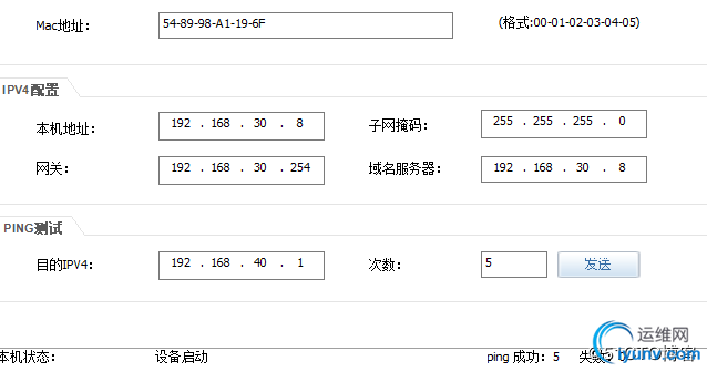

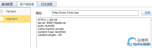

  六.全网互通
