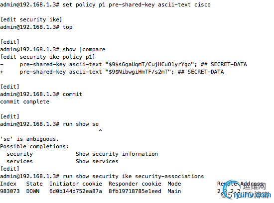

  第一步,修改域分享密码,把原先的Juniper换成Cisco,发现隧道down掉了:
  我们开始查看debub文件,搜索关键字设置为error:
  [Feb  1 10:14:24]<none>:500 (Responder) <-> 2.2.2.2:500 { 8bf32842 80c83c52 - c534184e 9f9eb944 [0] / 0x6a1843f7 } Info; Notification data has attribute list
  [Feb  1 10:14:24]<none>:500 (Responder) <-> 2.2.2.2:500 { 8bf32842 80c83c52 - c534184e 9f9eb944 [0] / 0x6a1843f7 } Info; Notify message version = 1
  [Feb  1 10:14:24]<none>:500 (Responder) <-> 2.2.2.2:500 { 8bf32842 80c83c52 - c534184e 9f9eb944 [0] / 0x6a1843f7 } Info; Offending payload type = 159
  [Feb  1 10:14:24]<none>:500 (Responder) <-> 2.2.2.2:500 { 8bf32842 80c83c52 - c534184e 9f9eb944 [0] / 0x6a1843f7 } Info; Offending payload data offset = 0
  [Feb  1 10:14:24]<none>:500 (Responder) <-> 2.2.2.2:500 { 8bf32842 80c83c52 - c534184e 9f9eb944 [0] / 0x6a1843f7 } Info; Error text = Incorrect pre-shared key (Invalid next payload value)
  [Feb  1 10:14:24]<none>:500 (Responder) <-> 2.2.2.2:500 { 8bf32842 80c83c52 - c534184e 9f9eb944 [0] / 0x6a1843f7 } Info; Offending message>  [Feb  1 10:14:24]<none>:500 (Responder) <-> 2.2.2.2:500 { 8bf32842 80c83c52 - c534184e 9f9eb944 [0] / 0x6a1843f7 } Info; Received notify err = Invalid payload type (1) to isakmp sa, delete it
  红色的字体很清晰的显示:不正确的域分享密码。
