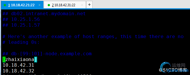

  配置文件:vim /etc/ansible/hosts

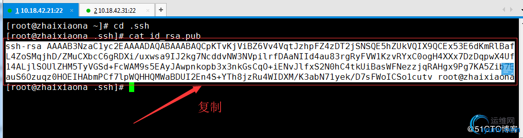

  vim /.ssh/authorized_keys

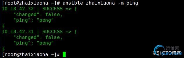

  一:测试目标主机是否在线:ping模块
  主机如果在线,则回复pong
  测试主机是否在线
  [root@zhaixiaona ~]# ansible zhaixiaona -m ping
  10.18.42.32 | SUCCESS => {
  "changed": false,
  "ping": "pong"
  10.18.42.31 | SUCCESS => {
  "changed": false,
  "ping": "pong"

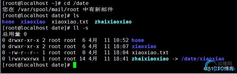

  新建一个文件
  [root@zhaixiaona ~]# ansible zhaixiaona -m file -a 'path=/date/xiaoxiao.txt state=touch'
  "changed": true,
  "dest": "/date/xiaoxiao.txt",
  "gid": 0,
  "group": "root",
  "mode": "0644",
  "owner": "root",
  "size": 0,
  "state": "file",
  "uid": 0
  "changed": true,
  "gid": 0,
  "group": "root",
  "mode": "0644",
  "owner": "root",
  "secontext": "unconfined_u:object_r:default_t:s0",
  "size": 0,
  "state": "file",
  "uid": 0

  为文件设置软连接
  [root@zhaixiaona ~]# ansible zhaixiaona -m file -a 'src=/date/xiaoxiao state=link path=/date/zhaixiaoxiao'
  "changed": true,
  "dest": "/date/zhaixiaoxiao",
  "gid": 0,
  "group": "root",
  "mode": "0777",
  "owner": "root",
  "size": 14,
  "src": "/date/xiaoxiao",
  "state": "link",
  "uid": 0
  "changed": true,
  "gid": 0,
  "group": "root",
  "mode": "0777",
  "owner": "root",
  "size": 14,
  "state": "link",
  "uid": 0

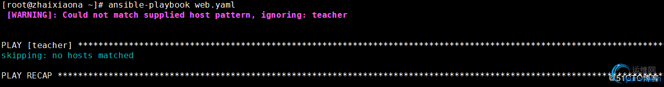

  修改nginx.conf测试:
  [root@zhaixiaona ~]# cat web.yaml
  - hosts: teacher
  remote_user: root
  tasks:
  - name: install nginx package
  yum: name=nginx state=latest
  - name: create nginx log directory
  file: path=/data/nginx_log state=directory recurse=yes
  - name: rm /var/log/nginx
  file: path=/var/log/nginx state=absent
  - name: create soft link
  file: path=/var/log/nginx state=link src=/data/nginx_log
  - name: copy nginx configure file
  copy: src=/etc/nginx/nginx.conf dest=/etc/nginx/nginx.conf backup=yes
  notify:
  - restart nginx
  - name: start nginx service
  service: name=nginx state=started enabled=1
  handlers:
  - name: restart nginx
  service: name=nginx state=restarted
  注:经测试,当不添加backerfs: yes参数时,匹配到后也会进行替换,但当匹配到的内容不存在时,会在最后增加一行;所以当不增加backerfs参数时,要确定匹配到的内容存在;
