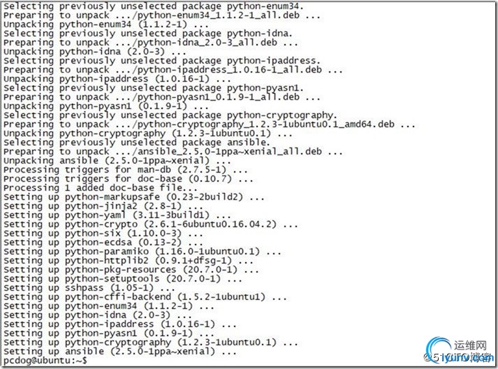

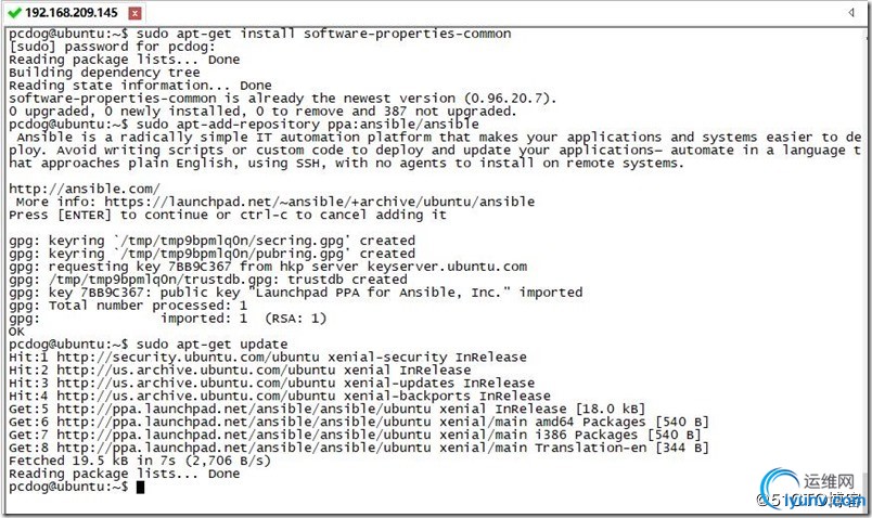

  $ sudo apt-get install software-properties-common
  $ sudo apt-add-repository ppa:ansible/ansible
  $ sudo apt-get update
  $ sudo apt-get install ansible

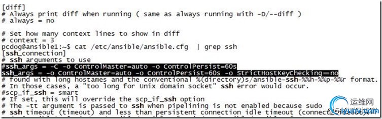

  sudo vi /etc/ansible/ansible.cfg
  #ssh_args = -C -o ControlMaster=auto -o ControlPersist=60s
  ssh_args = -o ControlMaster=auto -o ControlPersist=60s -o StrictHostKeyChecking=no

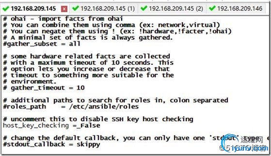

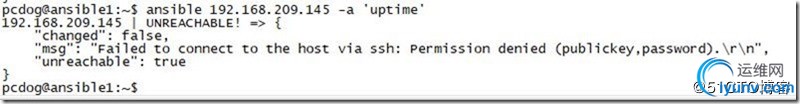

  host key 检查改为false
  居然拒绝了

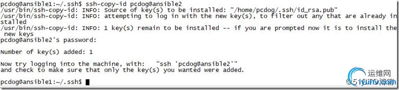

  我先生成个key
  ssh-keygen
  ssh-copy-id pcdog@ansible2
  ansible 192.168.209.146 -a 'uptime'
  可以看到受控机器的启动时间
