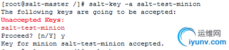

[root@salt-master /]# salt-key  -L#显示所有minion认证信息
  [root@salt-master /]# salt-key -a salt-test-minion   #接受salt-test-minion的认证信息;可跟参数 -y
  或
  [root@localhost /]# salt-key -A   #接受所有Unaccepted状态的minion认证信息
  The following keys are going to be accepted:
  Unaccepted Keys:
  minion
  Proceed? [n/Y] y
  Key for minion minion accepted.

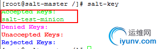

  Accepted Keys:
  minion
  Denied Keys:
  Unaccepted Keys:
  Rejected Keys:
  安装完成

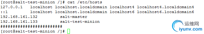

#[root@salt-test-minion /]# cat /etc/hosts     #salt-test-minion  的hosts文件
#127.0.0.1 localhost localhost.localdomain localhost4 localhost4.localdomain4
#::1 localhost localhost.localdomain localhost6 localhost6.localdomain6
#192.168.161.132    salt-master
#192.168.161.133    salt-test-minion

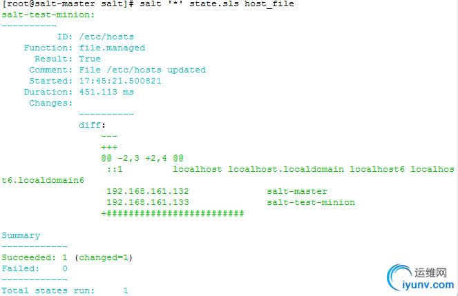

[root@salt-master salt]# salt '*' state.sls host_file
  到salt-test-minion上验证是否真的分发成功
