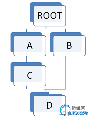

  多重继承:
  不能同时继承两父亲类和爷爷类比如B继承A,C继承时就不能同时写A和B,只写B就可以了。
class ROOT(object):
    def __init__(self):
        print(&quot;this is root&quot;)
    def action(self):
        print(&quot;ROOT is action...&quot;)
class A(ROOT):
    def __init__(self):
        super(A, self).__init__()
        print ('init A...')
    def action(self):
        print(&quot;A is action...&quot;)
class B(ROOT):
    def __init__(self):
        super(B, self).__init__()
        print ('init B...')
    def action(self):
        print(&quot;B is action...&quot;)
class C(A):
    def __init__(self):
        super(C, self).__init__()
        print ('init C...')
    def action(self):
        print(&quot;C is action...&quot;)
class D(B,C):
    def __init__(self):
        super(D, self).__init__()
        print ('init D...')
    def action(self):
        print(&quot;D is action...&quot;)
d = D()

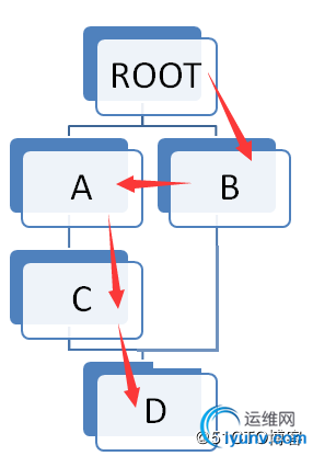

  要理解继承的顺序,因为当方法重名时,顺序靠后的方法覆盖前面的方法。
  类的继承关系:                D(A,B)实例化时候的继承先后顺序:先找B(及其父类),再找C(及其父类)
