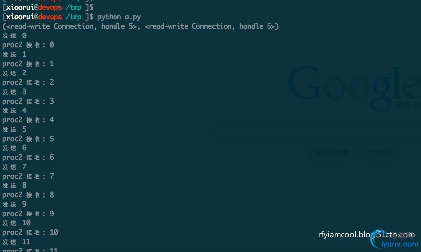

#coding:utf-8
import multiprocessing
import time
def proc1(pipe):
    while True:
        for i in xrange(10000):
            print "发送 %s"%i
            pipe.send(i)
            time.sleep(1)
def proc2(pipe):
    while True:
        print 'proc2 接收:',pipe.recv()
        time.sleep(1)
def proc3(pipe):
    while True:
        print 'proc3 接收:',pipe.recv()
        time.sleep(1)
# Build a pipe
pipe = multiprocessing.Pipe()
print pipe
# Pass an end of the pipe to process 1
p1   = multiprocessing.Process(target=proc1, args=(pipe[0],))
# Pass the other end of the pipe to process 2
p2   = multiprocessing.Process(target=proc2, args=(pipe[1],))
p1.start()
p2.start()
p1.join()
p2.join()
#原文: http://rfyiamcool.blog.51cto.com/1030776/1549857

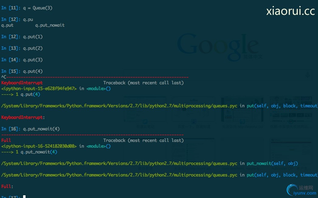

  我配置了multiprocessing队里长度是3个,然后当我放入的是第四个的时候, 会发现一只的堵塞,他是在等待,有人把数据get掉一个,那个时候 他才能继续的塞入 。如果用put_nowait()的话,队列超出会立马会一个error的。
  /System/Library/Frameworks/Python.framework/Versions/2.7/lib/python2.7/multiprocessing/queues.pyc in put_nowait(self, obj)
  /System/Library/Frameworks/Python.framework/Versions/2.7/lib/python2.7/multiprocessing/queues.pyc in put(self, obj, block, timeout)

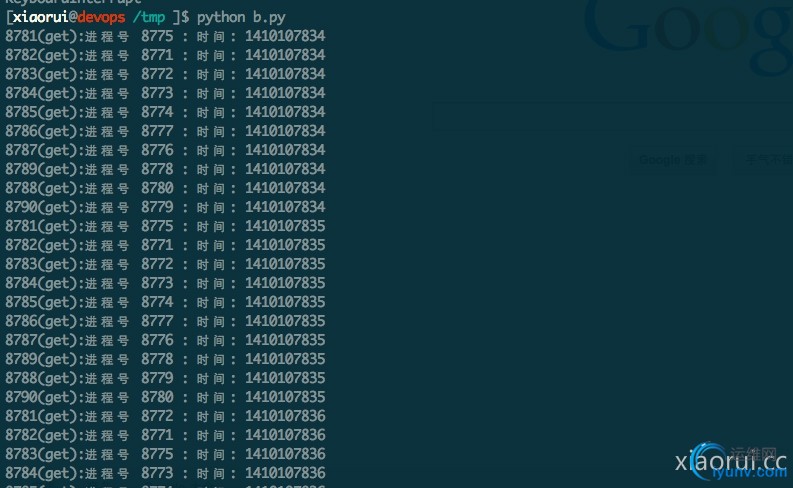

  下面是一段测试的代码,同学们可以跑跑demo,感受下。
#coding:utf-8
import os
import time
# 写入 worker
def inputQ(queue):
    while True:
        info = "进程号 %s : 时间: %s"%(os.getpid(),int(time.time()))
        queue.put(info)
        time.sleep(1)
# 获取 worker
def outputQ(queue,lock):
    while True:
        info = queue.get()
#        lock.acquire()
        print (str(os.getpid()) + '(get):' + info)
#        lock.release()
        time.sleep(1)
# Main
record1 = []   # store input processes
record2 = []   # store output processes
lock  = multiprocessing.Lock()    # To prevent messy print
queue = multiprocessing.Queue(3)
# input processes
for i in range(10):
    process = multiprocessing.Process(target=inputQ,args=(queue,))
    process.start()
    record1.append(process)
# output processes
for i in range(10):
    process = multiprocessing.Process(target=outputQ,args=(queue,lock))
    process.start()
    record2.append(process)
