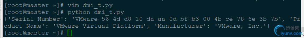

if  __name__ == '__main__':
    data   =  getData()
    lines = parseData(data)
    print getDmi(lines)
  看结果:
