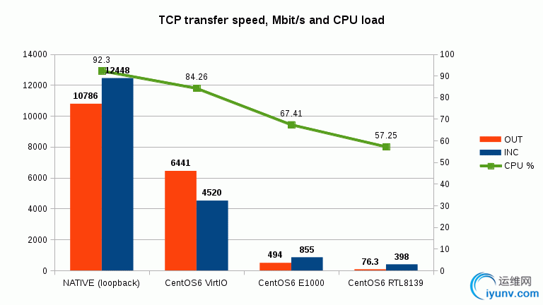

  Net speed now:
  In this case the paravirtualized network driver makes an huge difference: while it can't touch native speed, it is way ahead of the virtualized E1000 NIC adapter. The RTL8139 was benchmarked for pure curiosity, and it show a strange behavior: while output speed is in line with NIC speed (100 Mb/s), input speed is much higher (~400 Mb/s). Strange, but true.
  While host CPU load is lower on the full virtualized NICs, it is only because they deliver much lower performance. In other word, the Mb/s per CPU load ratio is much higher on the para virtualized network driver.

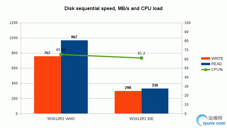

  Let see if Windows guest has some surprise for us. Disk benchmark first:
  This time, the fully virtualized IDE driver is much behind the para-virtualized driver. In other word: always install the paravirtualized driver when dealing with Windows guests.
