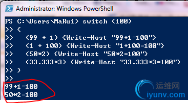

  判断语句为表达式的例子:
  • switch (100)
  •   (99 + 1) {Write-Host "99+1=100"}
  •   (1 + 100) {Write-Host "1+100=100"}
  •   (50*2) {Write-Host "50*2=100"}
  •   (33.333*3) {Write-Host "33.333*3=100"}
  运行结果:
