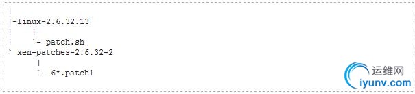

  The structure of these directories are as follows:
  ▲注:结构如上图。按照patch脚本,Linux-2.6.32.13 和xen=patches-2.6.32-2放在同一个目录。
