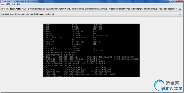

  4. Import the DevCloud ova image into VirtualBox.
      4.1 Verify PAE mode is active. Under the VM settings, System > Processor Tab, make sure 'Enable PAE/NX' mode is checked.
  5. Start the DevCloud VM. (Windows: It will complain that the virtual machine doesn't have vboxnet0.  Click on Edit Network to match it up with the default host only network.)
  6. After VM boots up, login into VM with username: root, password: password
Network
The default IP of DevCloud is 192.168.56.10, if you want a different IP (say you want to work with multiple DevClouds), change in /etc/network/interfaces and reboot.
