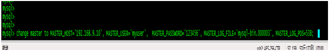

    mysql> slave stop;
    mysql> change master to
    -> MASTER_HOST='192.0.0.1',
    -> MASTER_USER='abc',
    -> MASTER_PASSWORD='123',
    -> MASTER_LOG_FILE='mysql-bin.000002',
    -> MASTER_LOG_POS=79;
    mysql> slave start;
