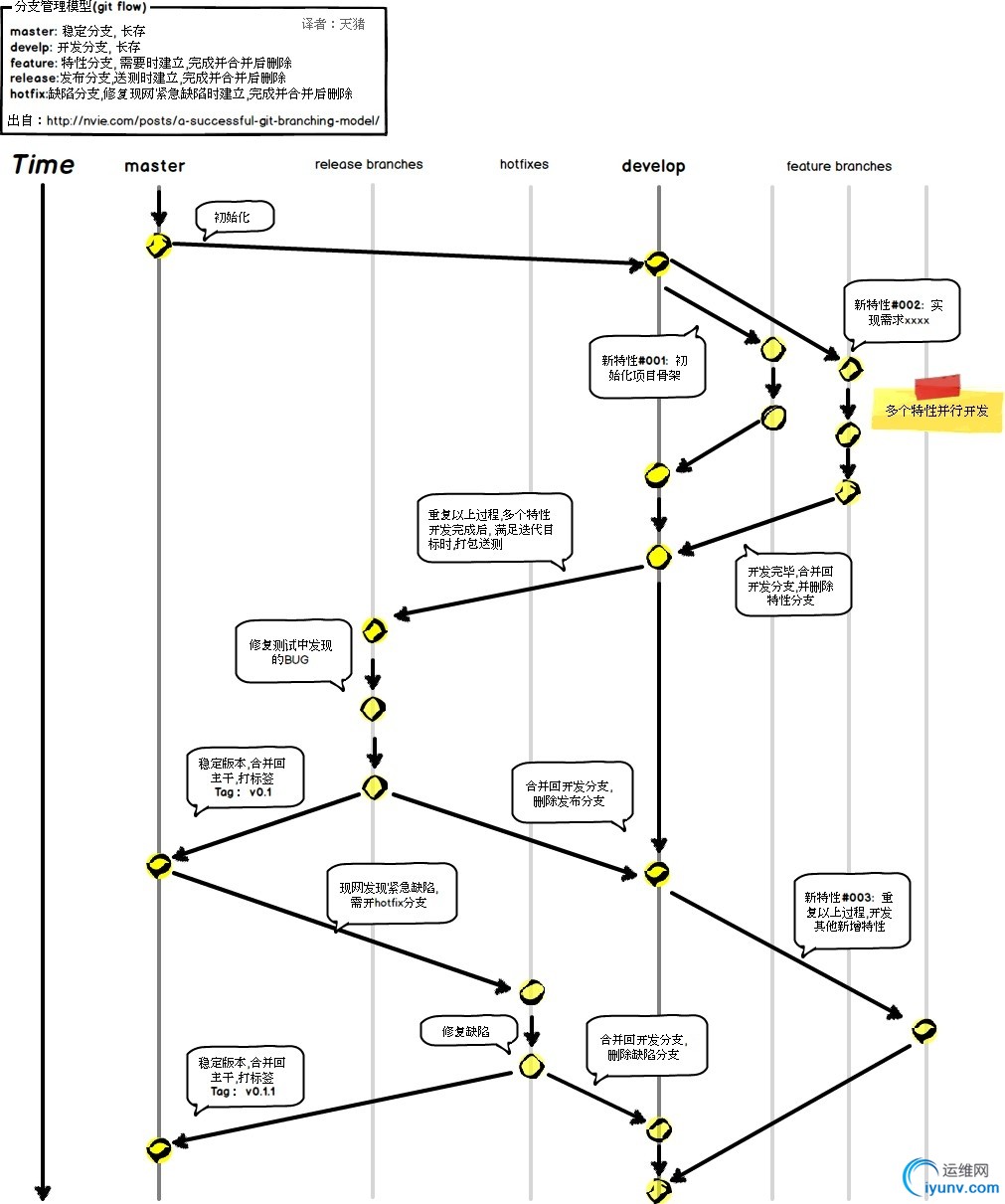

  四、git-flow --> 一个成功的Git分支模型
  介绍:http://nvie.com/posts/a-successful-git-branching-model/
  翻译:http://www.juvenxu.com/2010/11/28/a-successful-git-branching-model/
  工具:https://github.com/nvie/gitflow
  git-flow备忘清单:http://danielkummer.github.io/git-flow-cheatsheet/index.zh_CN.html
