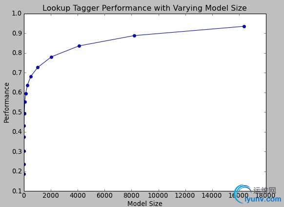

Let’s put all this together and write a program to create and evaluate lookup taggers having a range of sizes (Example 5-4).
Example 5-4. Lookup tagger performance with varying model size.
def performance(cfd, wordlist):
    lt = dict((word, cfd[word].max()) for word in wordlist)
    baseline_tagger = nltk.UnigramTagger(model=lt, backoff=nltk.DefaultTagger('NN'))
    return baseline_tagger.evaluate(brown.tagged_sents(categories='news'))
def display():
    import pylab
    words_by_freq = list(nltk.FreqDist(brown.words(categories='news')))
    cfd = nltk.ConditionalFreqDist(brown.tagged_words(categories='news'))
    sizes = 2 ** pylab.arange(15)
    perfs = [performance(cfd, words_by_freq[:size]) for size in sizes]
    pylab.plot(sizes, perfs, '-bo')
    pylab.title('Lookup Tagger Performance with Varying Model Size')
    pylab.xlabel('Model Size')
    pylab.ylabel('Performance')
    pylab.show()
>>> display()
Observe in Figure 5-4 that performance initially increases rapidly as the model size grows, eventually reaching a plateau(稳定水平), when large increases in model size yield little improvement in performance. (This example used the pylab plotting package, discussed in Section 4.8.)
Figure 5-4. Lookup tagger
