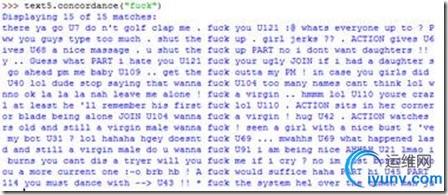

  There are many ways to examine the context of a text apart from(除了) simply reading it. A concordance(主要词语索引) view shows us every occurrence of a given word, together with some context. Here we look up the word monstrous(巨大的) in Moby Dick(白鲸记) by entering text1 followed by a period, then the term concordance, and then placing "monstrous" in parentheses(圆括号):
>>> text1.concordance("monstrous")
DSC0004.jpg Your Turn: Try searching for other words; to save re-typing, you might be able to use up-arrow, Ctrl-up-arrow, or Alt-p to access the previous command and modify the word being searched. You can also try searches on some of the other texts we have included. For example, search Sense and Sensibility(理智与情感) for the word affection(感情), using text2.concordance("affection"). Search the book of Genesis to find out how long some people lived, using: text3.concordance("lived"). You could look at text4, the Inaugural Address(就职演说) Corpus, to see examples of English going back to 1789, and search for words like nation, terror, god, to see how these words have been used differently over time. We’ve also included text5, the NPS Chat Corpus: search this for unconventional words like im, ur, lol. (Note that this corpus is uncensored(未经审查的)!) PS:那个聊天语料库,可以搜好多东西,例如…

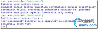

  A concordance permits us to see words in context. For example, we saw that monstrous occurred in contexts such as the ___ pictures and the ___ size. What other words appear in a similar range of contexts(出现在本文中类似的范围)? We can find out by appending the term similar to the name of the text in question, then inserting the relevant word in parentheses:
>>> text1.similar("monstrous")
  Observe that we get different results for different texts. Austen(奥斯丁,英国女小说家) uses this word quite differently from Melville; for her, monstrous has positive connotations(正面的涵义), and sometimes functions as an intensifier(强调成分) like the word very.

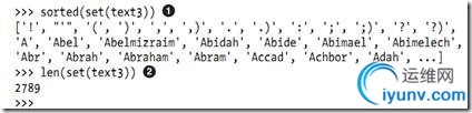

  The most obvious fact about texts that emerges from the preceding examples is that they differ in the vocabulary they use. In this section, we will see how to use the computer to count the words in a text in a variety of useful ways. As before, you will jump right in(马上投入) and experiment with the Python interpreter, even though you may not have studied Python systematically yet. Test your understanding by modifying the examples, and trying the exercises at the end of the chapter.
  Let’s begin by finding out the length of a text from start to finish, in terms of the words and punctuation symbols that appear. We use the term len to get the length of something, which we’ll apply here to the book of Genesis:
>>> len(text3)
44764
  So Genesis has 44,764 words and punctuation symbols, or “tokens.” A token is the technical name for a sequence of characters(标记是表示一个字符序列的术语)—such as hairy, his, or :)—that we want to treat as a group. When we count the number of tokens in a text, say, the phrase to be or not to be, we are counting occurrences of these sequences. Thus, in our example phrase there are two occurrences of to, two of be, and one each of or and not. But there are only four distinct vocabulary items in this phrase. How many distinct words does the book of Genesis contain? To work this out in Python, we have to pose(提出) the question slightly differently. The vocabulary of a text is just the set of tokens that it uses, since in a set, all duplicates are collapsed together. In Python we can obtain the vocabulary items of text3 with the command: set(text3). When you do this, many screens of words will fly past. Now try the following:
  By wrapping sorted() around the Python expression set(text3)① , we obtain a sorted list of vocabulary items, beginning with various punctuation symbols and continuing with words starting with A. All capitalized words precede lowercase words(大写单词排在小写单词前面). We discover the size of the vocabulary indirectly, by asking for the number of items in the set, and again we can use len to obtain this number②. Although it has 44,764 tokens, this book has only 2,789 distinct words, or “word types.” A word type is the form or spelling of the word independently of its specific occurrences in a text—that is, the word considered as a unique item of vocabulary. Our count of 2,789 items will include punctuation symbols, so we will generally call these unique items types instead of word types.
