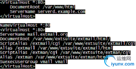

  [root@serverd extman]# vim /etc/httpd/conf/httpd.conf
  [root@serverd extman]# chown vmail.vmail /var/www/extsuite/extmail/cgi/ /var/www/extsuite/extman/cgi/ -R
  [root@serverd extman]# echo `10.14.4.63 mail.extmail.org` >> /etc/hosts

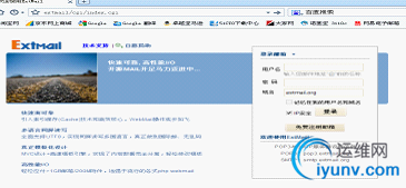

  访问mail.extmail.org:
  缺什么就装什么了:
  [root@serverd extmail]# yum install perl-CGI -y
  [root@serverd rpm_requires]# tar -zxf Unix-Syslog-1.1.tar.gz
  [root@serverd rpm_requires]# cd Unix-Syslog-1.1
  [root@serverd Unix-Syslog-1.1]# perl Makefile.PL
  [root@serverd rpm_requires]# yum provides */MakeMaker.pm
  [root@serverd rpm_requires]# yum install perl-ExtUtils-MakeMaker -y
  [root@serverd Unix-Syslog-1.1]# make && make install
  Ok,成功了
  免费注册试试:
  成功~~~
