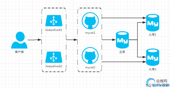

  简单说明拓扑关系:

  10.21.128.208:keepalived主
  10.21.128.209:keepalived备
  10.21.128.200:mycat1
  10.21.128.201:mycat2
  10.21.128.199:vip
  简单说明拓扑关系:
