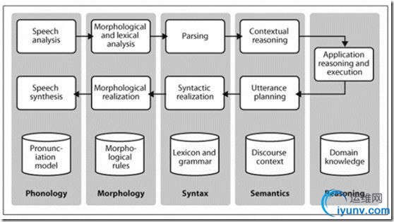

  Dialogue systems give us an opportunity to mention the commonly assumed pipeline for NLP. Figure 1-5 shows the architecture of a simple dialogue system. Along the top of the diagram, moving from left to right, is a “pipeline” of some language understanding components. These map from speech input via syntactic parsing to some kind of meaning representation. Along the middle, moving from right to left, is the reverse pipeline of components for converting concepts to speech. These components make up the dynamic aspects of the system. At the bottom of the diagram are some representative bodies of static information: the repositories of language-related data that the processing components draw on to do their work.
DSC0000.jpg Your Turn: For an example of a primitive dialogue system, try having a conversation with an NLTK chatbot. To see the available chatbots, run nltk.chat.chatbots(). (Remember to import nltk first.)
  Figure 1-5. Simple pipeline architecture for a spoken dialogue system: Spoken input (top left) is analyzed输入分析, words are recognized单词识别, sentences are parsed句法分析 and interpreted in context上下文解释, application-specific actions take place特定用途的行为发生 (top right); a response is planned, realized as a syntactic structure, then to suitably inflected words, and finally to spoken output; different types of linguistic knowledge inform each stage of the process.
