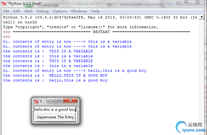

  下面是tkinter的获取文本框内容_给文本框添加键盘输入事件的操作
  运行效果:
  在输入的时候,单击回车键,触发:print_contents()
  代码部分:

40         # because it's being looked at by the entry widget, changing
41         # the variable changes the entry widget display automatically.
