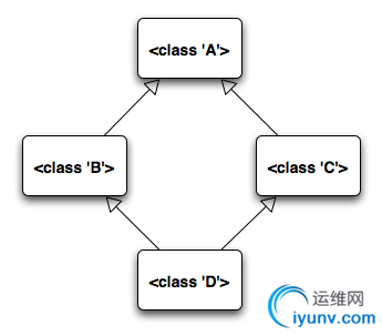

    Figure 2.1. The Diamond Diagram
  •   Now we're stuck if we want to implement do_your_stuff(). Using our usual technique, if we want to call both Band C, we end up calling A.do_your_stuff() twice. And we all know it might be dangerous to have A do its stuff twice, when it is only supposed to be done once. The other option would leave either B's stuff or C's stuff not done, which is not what we want either.

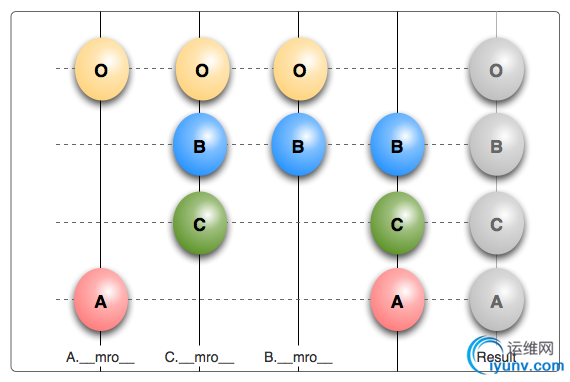

Figure 2.3. Beads on Strings - Unsolvable
  Beads can move freely over the strings, but the strings cannot be cut or twisted. The strings from left to right contain beads in the order of __mro__ of each of the bases. The rightmost string contains one bead for each base, in the order the bases are specified in the class statement.
  The objective is to line up beads in rows, so that each row contains beads with only one label (as done with the Obead in the diagram). Each string represents an ordering constraint, and if we can reach the goal, we would have an order that satisfies all constraints. We could then just read the labels off rows from the bottom up to get the __mro__for N.
  Unfortunately, we cannot solve this problem. The last two strings have C and B in different orders. However, if we change our class definition to class N(A,C,B), then we have some hope.

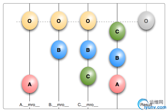

Figure 2.4. Beads on Strings - Solved
  We just found out that N.__mro__ is (N,A,C,B,object) (note we inserted N at the head). The reader can try out this experiment in real Python (for the unsolvable case above, Python raises an exception). Observe that we even swapped the position of two strings, keeping the strings in the same order as the bases are specified in the class statement. The usefulness of this is seen later.

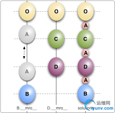

  Sometimes, there might be more than one solution, as shown in the figure below. Consider four classes class A(object), class B(A), class C(object) and class D(C). If a new class is defined as class E(B, D), there are multiple possible solutions that satisfy all constraints.
Figure 2.5. Multiple Solutions
  Possible positions for A are shown as the little beads. The order can be kept unambiguous (more correctly,monotonic) if the following policies are followed:
  •   Arrange strings from left to right in order of appearance of bases in the class statement.
  •   Attempt to arrange beads in rows moving from bottom up, and left to right. What this means is that the MRO ofclass E(B, D) will be set to: (E,B,A,D,C,object). This is because A, being left of C, will be selected first as a candidate for the second row from bottom.
  This, essentially, is the idea behind the algorithm used by Python to generate the __mro__ for any new type. The formal algorithm is formally explained elsewhere [mro-algorithm].
