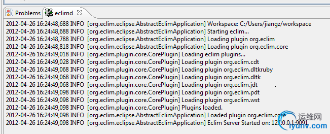

3. select Elcim->eclimd in the Show View dialog.
4. eclimd console will be shown. please see the following pictures.

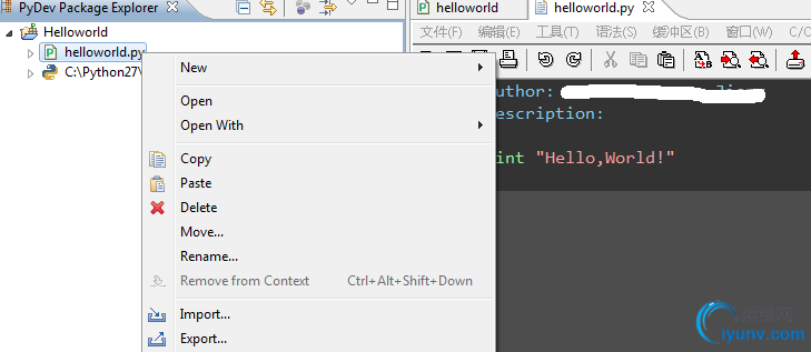

5.select one *.py files and select Open With command from RMB menu.
6.Vim editor will be shown in the eclipse.
