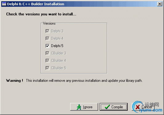

Installation
  Then install the Python for Delphi components from
     http://www.multimania.com/marat/delphi/python.htm
Python for Delphi is a set of components that wrap up the Python 1.5 Dll into Delphi. They let you easily execute Python scripts, create new Python modules and new Python types. You can create Python extensions as Dlls and much more, including being able to create classes in python and have Delphi use these classes as if they were native Delphi classes!
  so you finish up with the following palette:
DSC00011.gif which are the engine, the atomEngine, pythonDelphiVar, etc.  Note: You only need to use about three of these components to do most of your python-delphi work, the rest are mostly historical or very advanced.

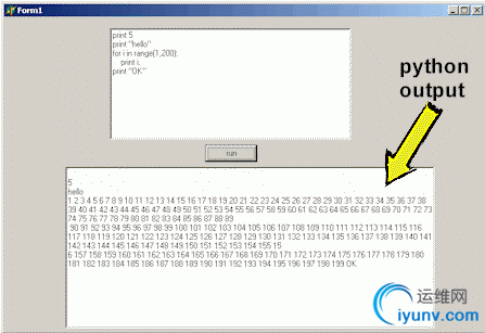

Basic Use - A simple test
  A simple Python evaluator:
  • Create a new Form
  • Drop a TMemo (or a TRichEdit)
  • Drop a TPythonGUIInputOutput
    for displaying Python's messages
  • Drop a TMemo for the source code
  • Drop a TPythonEngine
  • Connect the attribute IO of the
    TPythonEngine to the
    TPythonGUIInputOutput.
  • Connect the attribute Output of
    TPythonGUIInputOutput to
    the TRichEdit.
  • Drop a TButton and
    call it "Execute script"
  • Double-click on the button and add:

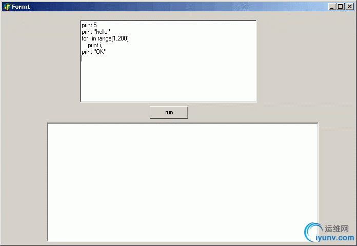

     PythonEngine1.ExecStrings( Memo1.Lines );
  • Write in the Memo1: some python code e.g. print 2+2 or
    that pictured below
  • Click on the Execute button
  click the button and
  python is working with Delphi at a rudimentary level.

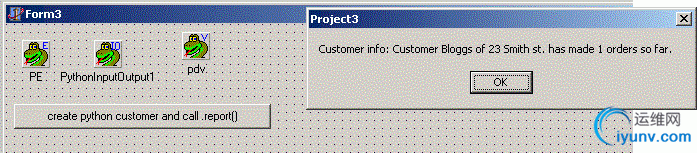

  • When this particular example delphi app runs, after the execution of the FormShow event, the customer instance will have been created and will be ready to be used. Let's add a button so that we can manipulate that instance.  Create a button and add the following code:
  aCustomer.Surname := 'Bloggs' ;
aCustomer.Address := '23 Smith st.' ;
inc( aCustomer.NumOrders );
showmessage( 'Customer info: ' +
aCustomer.RunReport() );
  That's it for the Delphi side of things.
  The Python side:
  Now let's work on the python side of things, which only involved creating a single python unit named YourPythonApp.py in the same folder as your delphi app.
class Customer:
def __init__(self, surname=''):
self.Surname = surname
self.Address = 'unknown address'
self.NumOrders = 0
def RunReport(self):
return 'Customer ' + self.Surname +
' of ' + self.Address +
' has made ' + `self.NumOrders` +
' orders so far.'
  Note that the method __init__ in the above class is the  constructor method (like .Create in Delphi).
  Running the Delphi app and clicking the button should give you:
  Success!
