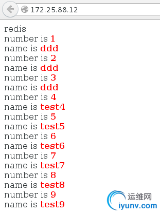

检验
server11:
  mysql> update test.test set name ='ddd' where>server12:
  [root@server13 redis]# redis-cli
  127.0.0.1:6379> get 3 "ddd"
  更新mysql数据库的值,也能实时同步到redis中,并被客户端获取
  客户端:
  浏览器访问 http://172.25.88.12/
