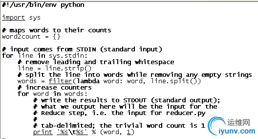

Mapper:

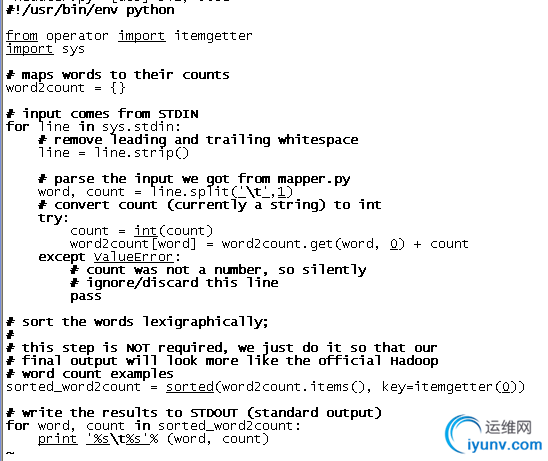

Reducer:
注意脚本程序需要有足够的权限,使用命令:chmod a+x Mapper.py;chmod a+x Reducer.py.
