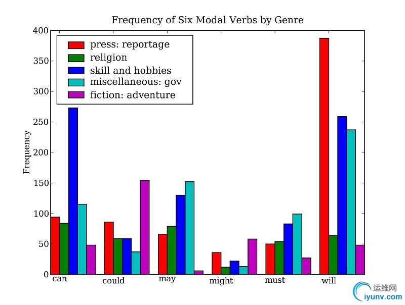

  So far we have focused on textual presentation and the use of formatted print statements to get output lined up in columns. It is often very useful to display numerical data in graphical form, since this often makes it easier to detect patterns. For example, in Example 3.7 we saw a table of numbers showing the frequency of particular modal verbs in the Brown Corpus, classified by genre. The program in Example 4.13 presents the same information in graphical format. The output is shown in Figure 4.14 (a color figure in the graphical display).

     Example   4.13 (code_modal_plot.py):
  Figure 4.13: Frequency of   Modals in Different Sections of the Brown Corpus
  Figure 4.14: Bar Chart(柱状图) Showing Frequency of Modals in Different Sections of Brown Corpus
  From the bar chart it is immediately obvious that may and must have almost identical relative frequencies. The same goes for could and might.

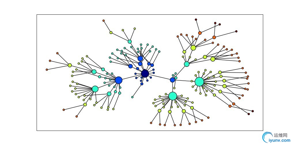

  The NetworkX package is for defining and manipulating structures consisting of nodes and edges, known as graphs. It is available from https://networkx.lanl.gov/ . NetworkX can be used in conjunction with Matplotlib to visualize networks, such as WordNet (the semantic network(语义网络) we introduced in Section 2.5). The program in Example 4.15 initializes an empty graph  then traverses the WordNet hypernym hierarchy adding edges to the graph . Notice that the traversal is recursive , applying the programming technique discussed in Section 4.7. The resulting display is shown in Figure 4.16.

     Example   4.15 (code_networkx.py): Figure 4.15: Using the NetworkX   and Matplotlib Libraries
  Figure 4.16: Visualization with NetworkX and Matplotlib: Part of the WordNet hypernym hierarchy is displayed, starting with dog.n.01 (the darkest node in the middle); node size is based on the number of children of the node, and color is based on the distance of the node from dog.n.01; this visualization was produced by the program in Example 4.15.
